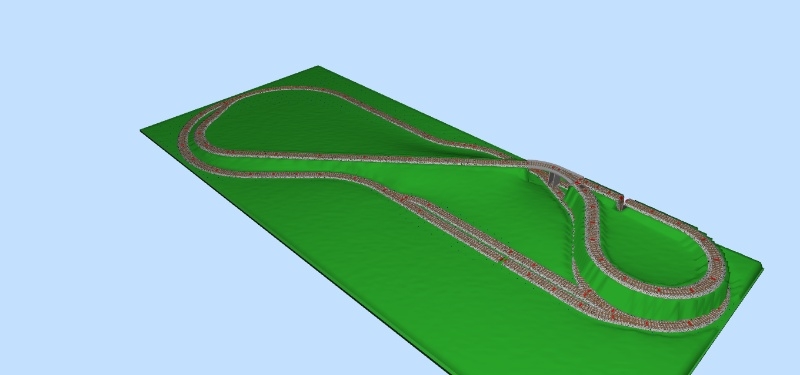

Progress, the site has been surveyed and a plan drawn up on Scarm. This is it - it is quite simple but with the cross loop section and the reversing branch should be fun.

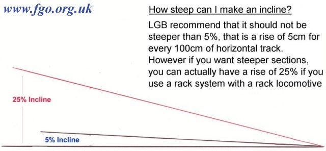

Great news Graham.
This may be of some help when building your incline.

Thanks Maurice the gradient on the branch is 4% so should be OK I think.

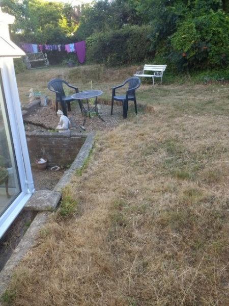

This is the site.
The table and chairs will be in the middle of the circuit with the high level reversing loop nearest the camera. The passing loop will be next to the wall so it will be easy to put the trains on the track bed about 33 inches above the path by the conservatory.

The plan has changed slightly based upon a better garden survey. The branch gradient has been eased. I costed the track from an on line site and was a bit gob smacked at the total price - in excess of £1000. EBay here we come! The plan is to build the lower level first and proceed with the branch as funds permit.
