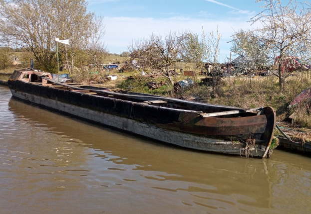

We have had out first trip of the year. A cruise to Woolfhampcote and back. It takes about 3 hours, gorgeous sunshine.
The sunken boat at the end isn't sunk anymore.

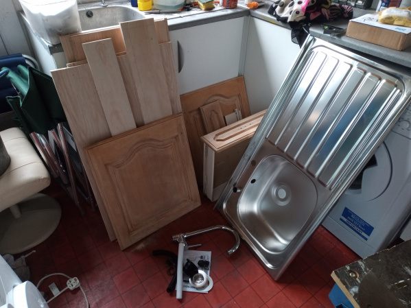

Progress on the new kitchen unit is good. I started with a large piece of plywood, a new sink, new taps and produced a kit of parts.
I have made a bit of a start.

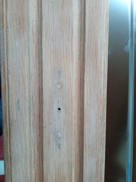

The old doors and drawer fronts are solid wood so will be reused. There are some unnwated holes in the drawer fronts so I turned down some dowels to plug them.

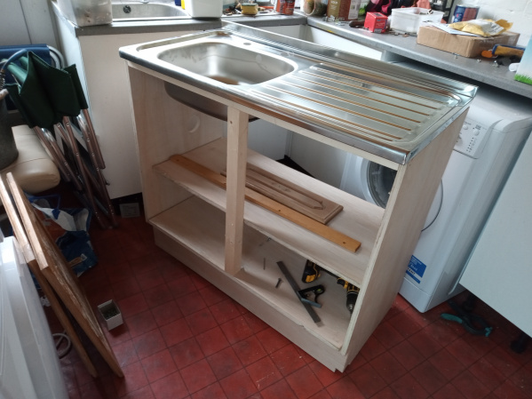

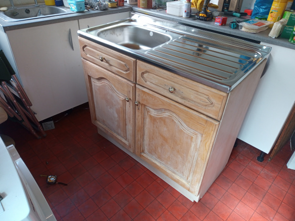

Initial assembly has taken place.
I have now taken it apart to produce a final kit of parts that now include all the right conncetors in the right places. I will now varnish all the panels before taking then to the boat for assembly on site.
The doors look quite attractice at first sight but a closer inspction will reveal marks from water damage and modifcations over the years so they will be painted with a kitchen cupboard paint which will make the boat look a bit more modern and be easier to clean.

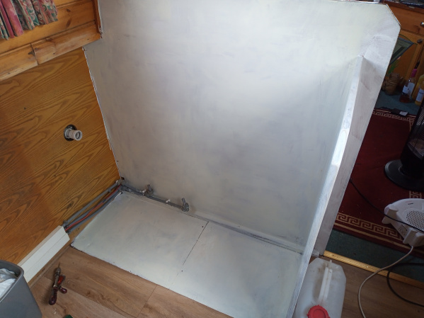

I have cleaned and painted (it was gross) the space into which the kitchen sink unit will go.
Home now and doing some final painting of the rebuilt unit prior to an intended trip to install it next weekend.

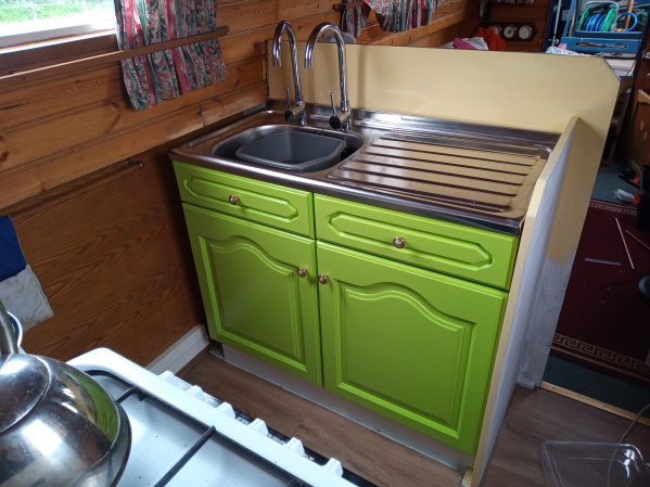

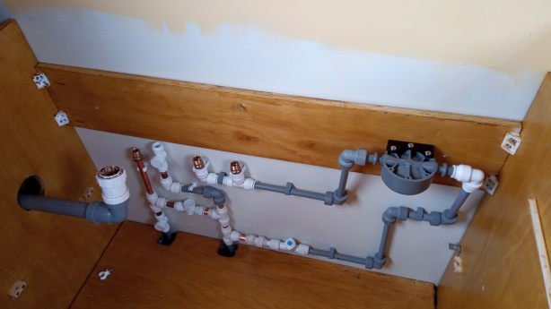

The sink!
First the plumbing. It is a bit complicated as it feeds two identical mixer taps (identical for appearance sake) The left tap mixes unfltered hot and cold water, the right is filtered cold water in either direction. I also have to plan for winterisation and therefore need to isolate completely the right hand tap and be able to connect the left to cold only. This is because the hot water is complelty drained in the winter as the tank is in the unheated engine bay but we can temporarily refill the cold whlist we are on board and then drain it again before we leave.
The shelf put in the pipe second from the left has a temprary stop cock on it. That has been replaced with the tap fitting.
The drawer support in.
The drawer in
The sink and false drawer front in.
The finished (almost) article.
There is still some wood to put up on the left and some sealent to do plus some painting on the end panel

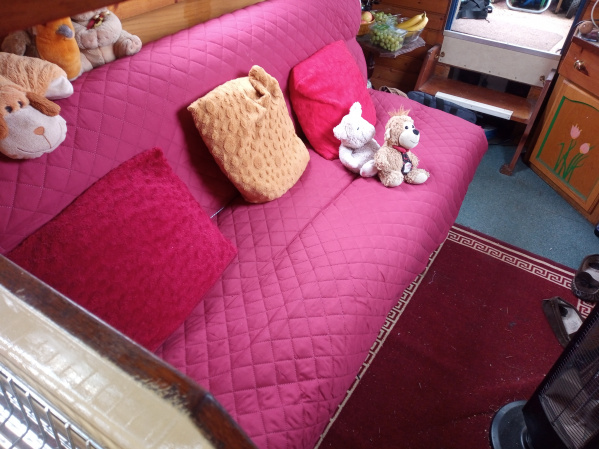

We have a cover for the sofa bed. The sofa is very comfy but it is a light colour and shows up every mark. We have bought a washable cover for it. The cover is good but didn't stay on very well so I have added straps and clips to hold it on place. It works well now.
