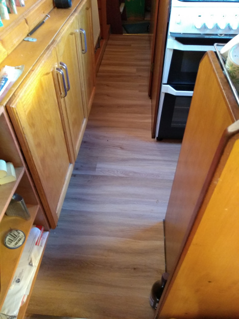

Jo had a happy time at the weekend ripping up old floor tiles. The boat has these old style vinyl tiles which have seen better days. They are going to be replaced with solid vinyl planking in the kitchen and corridor areas. They are under carpet tiles in the lounge.

We are on the boat again. We have sterilised the water system, changes the engine thermostat and laid the new floor on the kitchen and gangway. It is the new solid vinyl planking which can survive the damp.

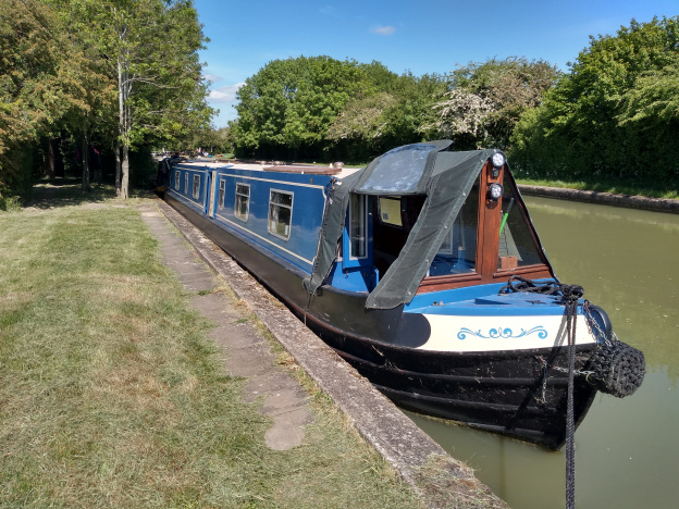

She is still afloat!
There was no money left on the electricity meter so we have topped that up. I removed a large amount of bird poo from the roof and sides were she sits under the tree and we met our knew neighbour Ben. He is now working at Calcutt as a mechanic. We also saw our old neighbour who had moved into the marina for safety during the lockdown. She is moving back up to near us shortly.
If only the motorways were this quiet normally!

It was good, mostly reassuring, the stern gland hadn't leaked at all and no rain had got in the bilge and she hadn't been vandalised unless you count the actions of the birds.
We will probably do a day trip again in about a month unless they allow us to stay overnight before then.

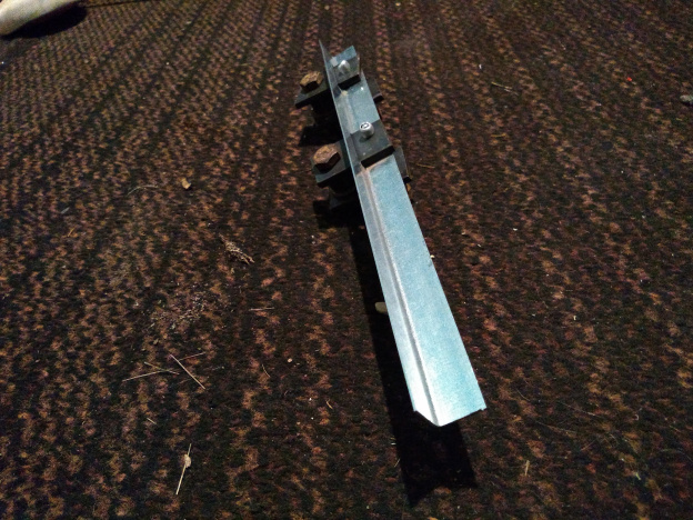

This was also the first chance to try out my new Gurney flap. The tiller load is considerably reduced and it doesn't seem to cause any steering problems when turning round.

Graham and Jo wrote:
......This was also the first chance to try out my new Gurney flap. The tiller load is considerably reduced and it doesn't seem to cause any steering problems when turning round......Cheers Graham
I have heard of this for other things but what is on the boat, please.
 Post subject: Re: DOTTEREL
PostPosted: Wed Jun 03, 2020 11:09 am
It was invented in the 70's to improve racing cars.
There is a description of it here https://en.m.wikipedia.org/wiki/Gurney_flap
My version looks like this
It sticks out 15mm at the back of the rudder. It seems to produce a sideways force without very much defection of the wake. My previous attempts were more like a normal flap which also deflected the wake and caused problems turning round.

Thanks Graham. I knew it was used for racing cars but wasn't sure how it would be used on boats.
