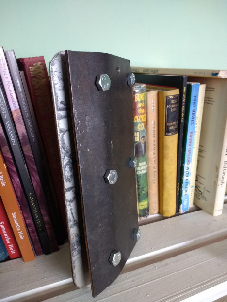

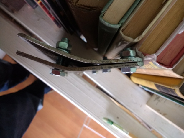

I have made a new trim tab.
It is made from two bits of 3mm steel so is stronger than the last one and is clamped in 3 places rather than two. I have measured it so I can tell the boatyard what size it is when the time comes to do it properly. I hope it will stay on so that I can show them.
I used my previous design technique of hit it with a large hammer until it looks about right. I was heading for around 30 degrees, it is actually 29!

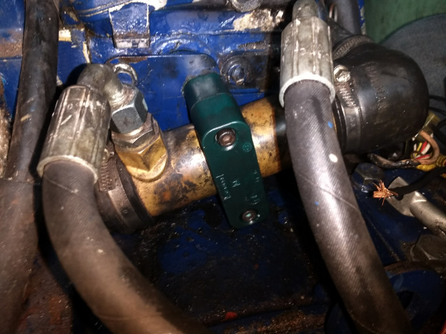

I have removed the burnt oil cooler support or at least what is left of it. One of the mounting bolts has a very damaged thread, I guess this precedes our ownership of the boat. Fortunately the thread in the plate attached to the engine is good so I just need another bolt.

The old oil cooler mount or what was left of it has been removed and a new one fitted. The wires that ran across this area have now been replaced. I have one connection still to do then the boat is canal worthy again.
 Post subject: Re: DOTTEREL
PostPosted: Tue Feb 19, 2019 12:09 pm
Rewiring complete and everything works. The stop button is more effective, stopping the engine instantly rather than feeling like you need to press it harder to stop the engine so I think I have fixed a fault on the way. I did find a dodgy connection on the power side where the wire broke when I touched it. It had been crimped into a bigger connector which is always a bad idea.

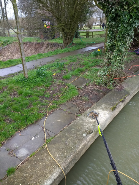

I decided to dredge our mooring, it is a bit shallow. So I decided to run the boat in reverse whilst tied up and use my rake to clear the silt. It seemed to work but I could feel some obstructions.
This is what I pulled out.
