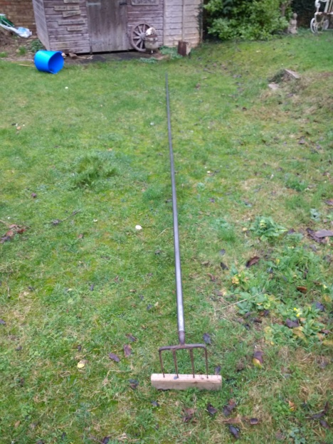

I have put a steel pole on to my keb. It is currently in two 3 metre bits. The pole is sold by metals4u as telescopic. That is one piece fits perfectly in the next size down. The larger diameter pole was chosen to go over the rake head and the smaller diameter to go in the larger one. They are all held together with those springy button type things.
I went for 6 metres i.e. about 19.5 feet on the basis that a brick on the cill (I have had one of those) requires 4.5 feet of water, 10 feet or so of air and say 5 feet to use above the lock side to reach it.
I hope I can store 3m lengths in the engine bay. If not I will have to make it 4 1.5 metre lengths.
On things like the BCN challenge it will travel on the roof fully assembled.
I am hoping that the 3mrtre sections will
