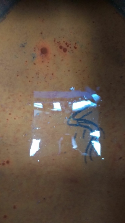

I'm on the boat for a week or so. It is water tank time again. This is what I found.
Not to bad, the worst bit was on the wall between the tank and the lounge.
I have been in there with the angle grinder and have now rust killed it with Fertan.

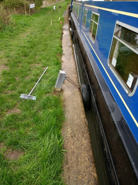

I have also been cleaning the wall by the boat.

Whatever the 'rash' is in the first picture, I hope that it's not catching?
 Post subject: Re: DOTTEREL
PostPosted: Sun Apr 22, 2018 7:24 pm
The rash is a bit interesting. It seems to be directly under the filler and not conventional tank corrosion. Who knows what comes in with the water. It has all gone now.

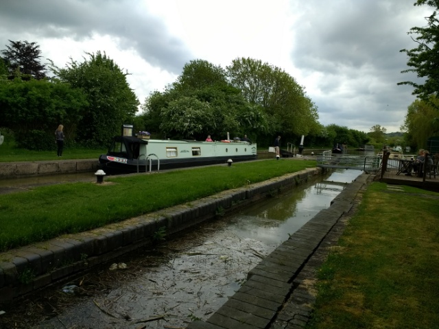

Pictures of the tank are boring so here are two at the lock.
