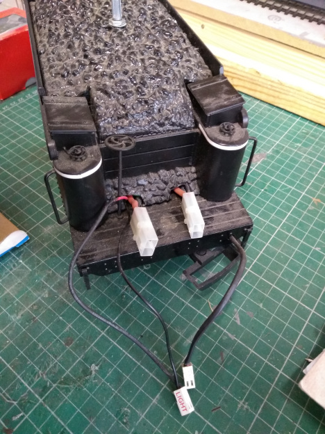

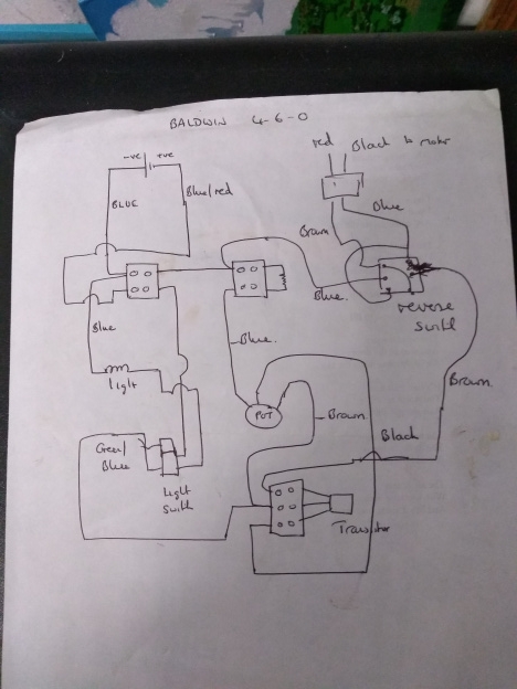

The two battery engines are both Bachmann big haulers, the 4-6-0 is pretty much as original but I have fitted two large rechargable battery packs in the tender. There is a simple control system with an on/off switch, a direction switch and a potentiometer to control speed via a power transistor.
The porter does not come with a tender but I had a spare from a big hauler that died so fitted the same system in that and semi permanently attach it to the engine.
I will upload a picture of one of the tenders and a wiring diagram.

Wiring diagram - essentially a potentiometer driving a power transistor. There is also a light on the tender and one in the engine so one of the switches controls which light is on and the other which direction to go.

The front connectors. The engine came with two connectors between the loco and tender. One for the tender light and the other for the chuff chuff sound system. The sound system had to go to make room for the batteries. So one wire now drives the engine light and the other provides power to the motor. The other two connectors are to charge the two 8 volt battery packs. The packs are wired in series to give a potential 16volts.

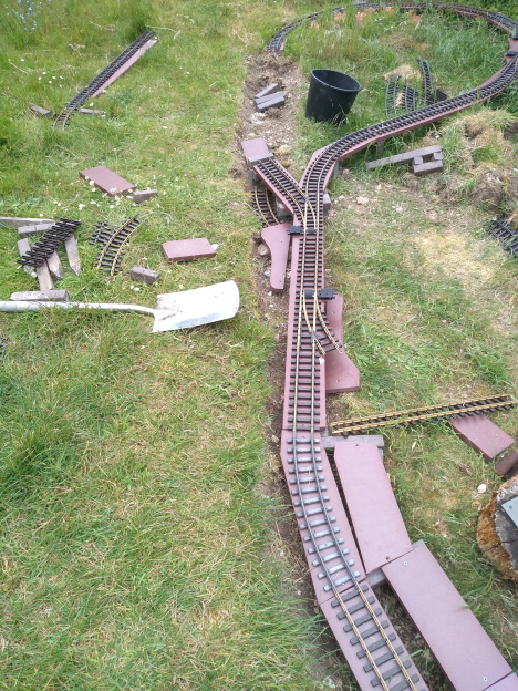

PostPosted: Sun May 10, 2020 3:26 pm
I am rebuilding the two junctions that had the double curve. I also found that one was not very level so have had to replace the ground supports. My early technique of pile driving was quick but not accurate. I now assemble the supports place them in a hole level everything and pack the soil down around them. Takes a while but the result is much better.
I have also lowered the ground level here to aid future maintenance.
PostPosted: Thu May 14, 2020 6:44 pm
Well we all make mistakes!!
I finished rebuilding the section that had the reverse curve before the point. I have made a much better job of it and the track layout is neater. It is also perfectly level.
Test run with the big hauler - it fell off as before. After a lot of trying things including tightening the check rail I discovered that the middle wheel set was lose and dropping below rail height and chucking the engine off on the check rail. I tightened up two screws in the chassis and everything is now fine. It even goes through the reverse curve entering the loop!

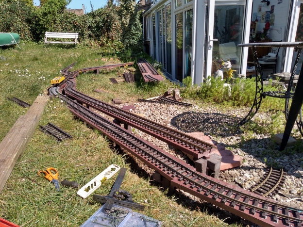

PostPosted: Wed May 27, 2020 5:27 pm
Work is progressing well. I am building the high level reverse loop next and will joining the existing section of branch line after that. This is to makes the task of aligning the levels a bit easier as they will meet up on a decent length of straight so a few mm out in height will be no problem.
