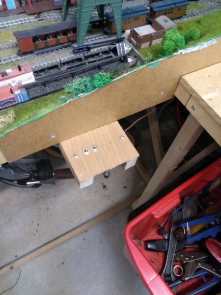

Work is starting on the modern circuit plus a few other odds and ends.
The new control panel for the modern circuit is getting there. These are mostly point control switches.

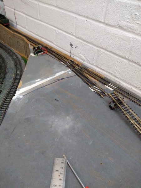

And talking of point the first track has been laid in the new station. The first point needed a surface mount point motor because of structure underneath. I am using medium radius electrofrog points with the frog polarity switched form the point motor. I am also taking a great deal of care to level everything. I am glad I built the baseboard strong enough for a party as access is difficult there so I get on top of it!
I have also include a small control panel to operate the points in Little Snoring Quayside.
I have had to rework the level crossing gate in the fence of Samton as it was too close to the track and the trains delivering beer to dear daughter's house kept hitting it.

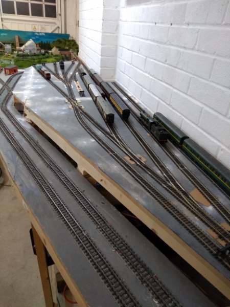

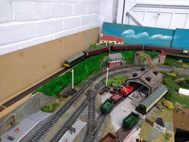

Track laying in the modern station is complete (except for ballasting). The track has been laid with electrofrog points. There are two main buses underneath and all sections of track are connected to them.
There is a double slip giving access to teh sidings and head shunt.
Beyond that a three way point to provide access to the engine shed.
The logic of wiring the two point motors so that you can't move the wrong blade first took some mental effort. You have to switch the frog polarities on these points. I have two of teh new automatic frog switchers from Gaugemaster. They only work on DCC and detect the incoming wheel polarity - as it is AC I guess it detects the phase.
I also have an inspection pit next to it.
The track terminates near the lower level lifting section but a future project is to build a second bridge.
On other side of the railway, after the narrow guage and standard guage separate, the track needs to be extended to provide a temporary run round loop until the bridges is completed.

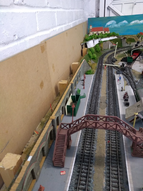

The track has been lifted, fortunately I listened to Maurice when I laid it and used the same make if PVA so it softened nicely with an application of water.
I also decide to bite the bullet and pull up the underlying supporting structure as it had a down gradient on a curve followed by a corresponding up gradient. These were left over from the previous design but we're causing problems with some rolling stock.
The scene of devestation behind the wall.

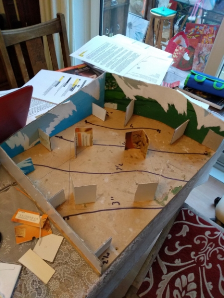

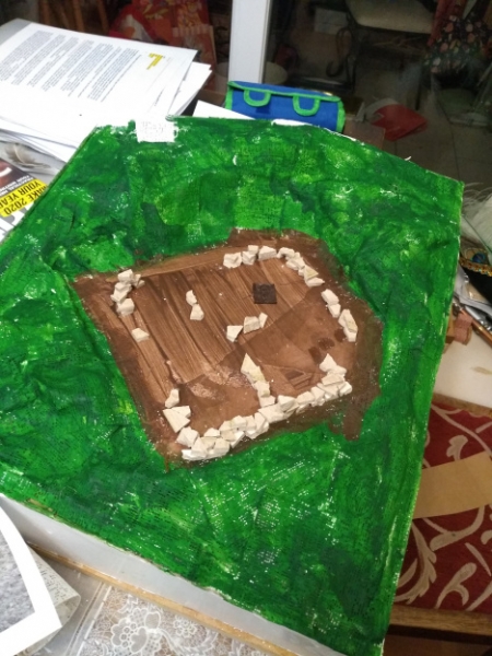

I have started on the site of the roman dig.
I just need to build the landscape and dig a hole!
I start landscapes with contour lines hence the black felt tip.
Somewhere under there is our dining room table. Jo has covered the rest in work on her book.

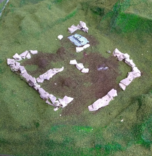

The dig is going well, they have uncovered a Roman Villa.
The major work has been done with a JCB.

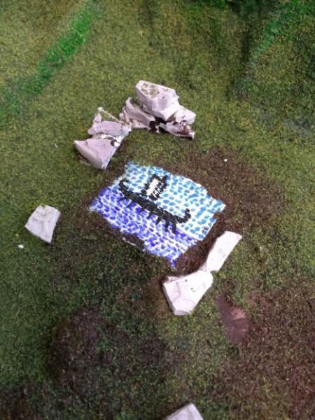

So far they have uncovered a mosaic showing an early canal craft.
Apparently it is by the famous artist Jo!

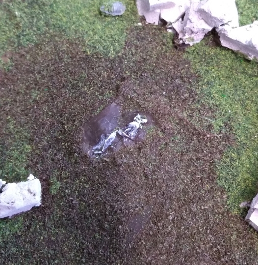

And they have found a skeleton.
The team are away at the moment but will be back in their trusty Landrover and a famous TV outside broadcast unit. The grass will probably grow in the meantime and a few hedges may sprout up.
