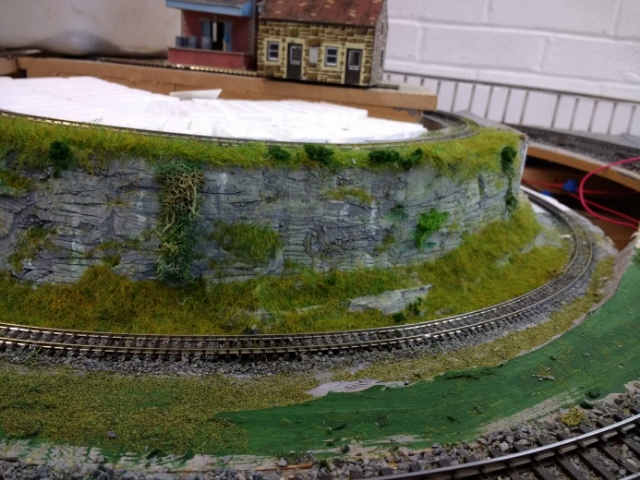

PostPosted: Sun Feb 18, 2018 10:37 pm
I was admiring the cliff faces in your gallery, are they self made/moulded, They look really effective. :D
PostPosted: Sun Feb 18, 2018 11:16 pm
It is just plaster laid over polystyrene blocks then flattened when dry with a large screwdriver, carved with a craft knife and painted with gouache.

Work continues the cliff has now got some greenery and been painted with a few different colours.
PostPosted: Wed Mar 21, 2018 8:25 am

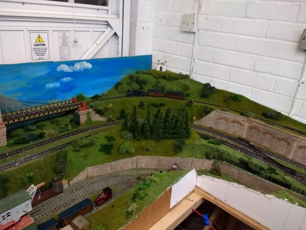

PostPosted: Sun Aug 12, 2018 7:58 pm

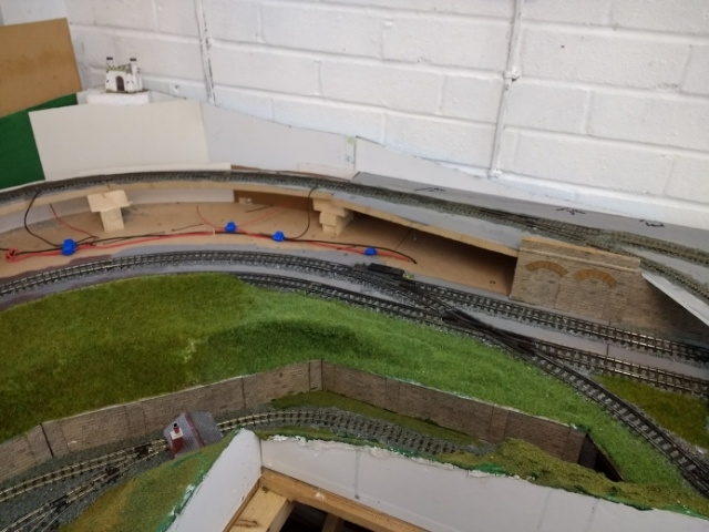

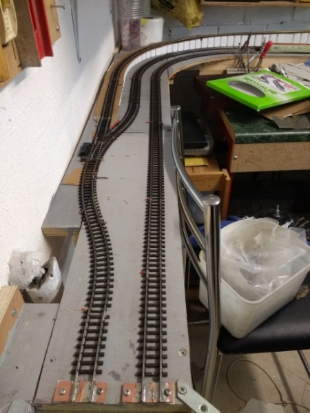

Considerable work has been going on but most of it below the track. The modern circuit is now complete and the station is on its way.
With the DCC system I found that relying on fishplates is a bad idea so every piece of track has droppers to a bus underneath the board. This takes a while.
This is where the two systems separate via my modified Triang point, originally the Triang circuit was straight here but that meant the modern trains had to go through a curve on the modified points. Not good, so I reworked it to give the modern trains a straight run through the point.

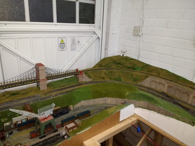

I have also started work on the hill in the coner above the quayside. One part of the wall is complete. The scenery will be mouse proof of course.

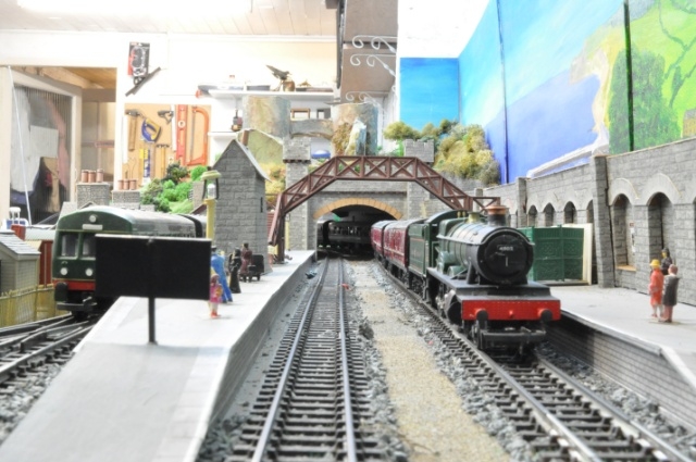

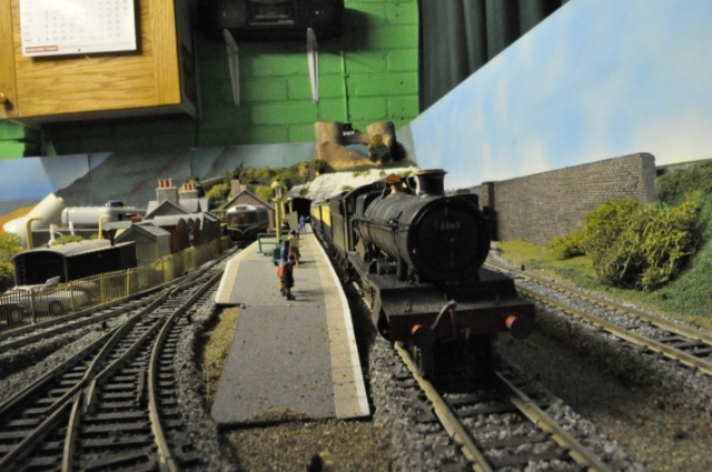

I came across an old photo of Little Snoring in the Marsh so took one of it now.
2010 Hornby Grange in platform Class 121 in bay.
2018 Hall in new 2nd platform, class 101 in the bay.
So we have a new platform, new tunnel, footbridge and the castle has moved!

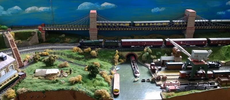

PostPosted: Sun Sep 09, 2018 1:58 pm
I have been working on the undeveloped corner near Little Snoring Quayside.
New mouse proof scenery. You can also see the old board that was intended to support a backscene.
This is the same are treated with basic surace texture prior to static grass.
I have also trimmed the back scene support boards and painted them with a sky effect. This may become permanent. Sky doesn't suffer from perspective or point of view problems!

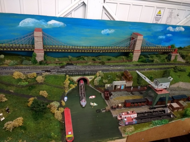

PostPosted: Sun Oct 28, 2018 10:26 pm
The chapel corner is now compete - I will need to add some cameos I think, perhaps some vampires by the chapel and wolves in the wood. Do you recognise the trees Maurice?
The bit under the suspension bridge is now complete too.
